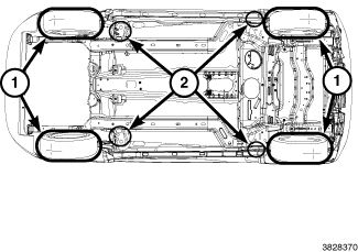

Anybody knows where exactly is the spot to lift the car? There’s this large hole with some rubber near a small hole at the rear, is it there supposed to be?

    If you're using the correct Fiat jack, there are small arrows on bodykit. The sill welds are 'reinforced' at those points; you have to lie down to see the weld. If not using the 'standard' jack, I've no idea! If you lift at the wrong point on the sill, you'll buckle it.  :(

    According to info on another site for places to put axle stands:
    "At the front, it is the chassis reinforcement leg. The rear is on the pinch weld seam that runs along the bottom of the rocker panel. The location, depending on your model, is noted by an arrow stamped into the rocker panel or sideskirt." (2 in the below pic from the service manual)
