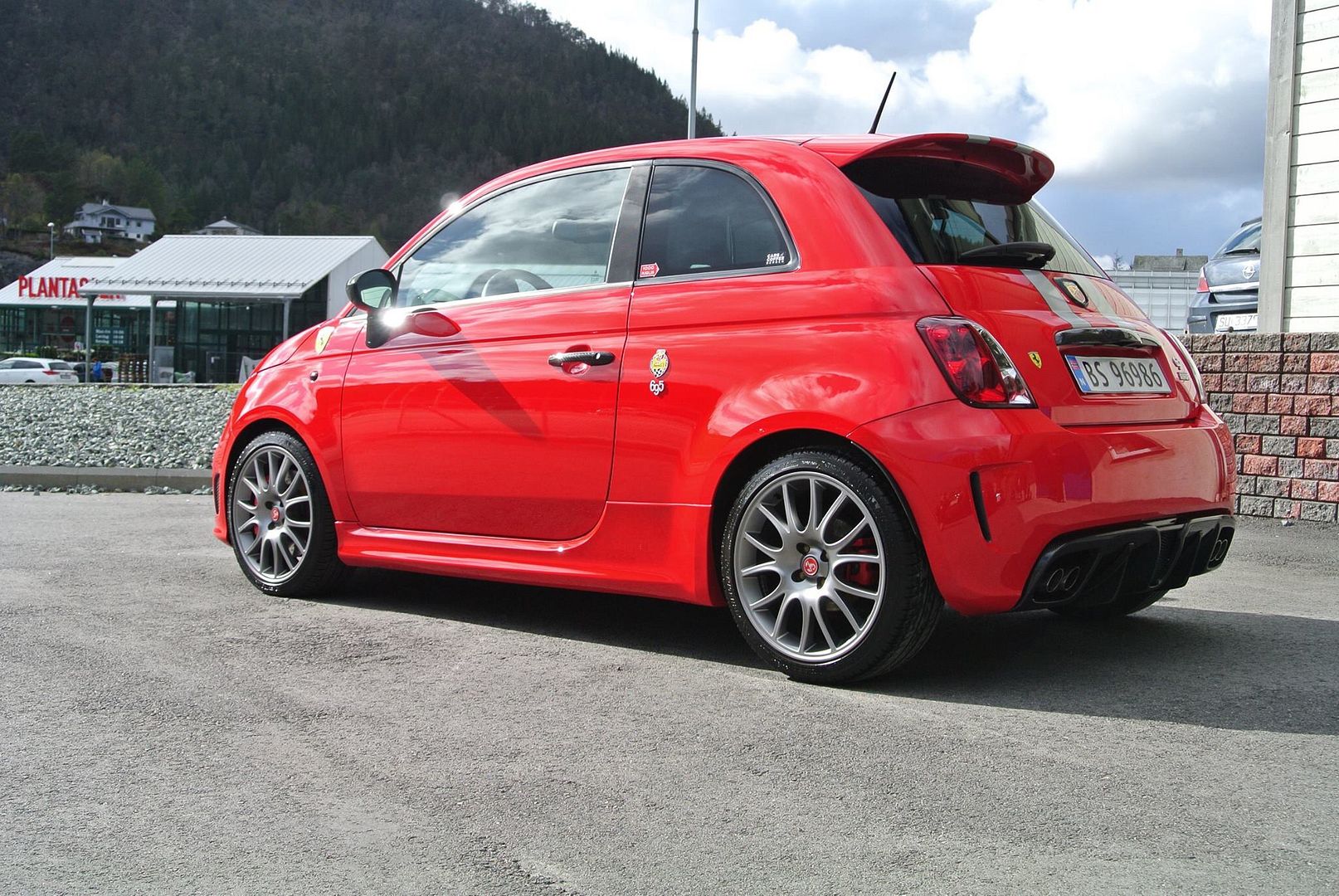

ENGINE:
TMC ECU tuned 1.4 T-Jet - Garrett Turbo - approx 215hp.
TMC ECU tuned MTA Competizione gearbox
STANDARD KIT
695 Brembo brakes
Carbon backed Leather and alcantara Sabelts
Tributo Ferrari wheels
Carbon dashboard
Carbon mirror caps
Carbon Door inserts
Tributo Ferrari Handmade Leather luggage and documents holder from Italian Tremontana
Blue & Me Abarth Navi and telemetry
Record Monza Exhaust
Interscope
MODIFICATIONS:
TMC ECU Engine tune
TMC ECU gearbox tune
Bilstein B14 coilovers
DNA Front Suspension Arms
DNA Front Sway Bar Tie Rods
DNA Front Strut bar
DNA Front lower chassis brace
DNA Rear Adjustable Torison bar
Scara73 Carbon Air intake and cover (Biposto style)
FiftyGo Carbon diffusor
Koshi Carbon front splitter
Koshi Carbon door handle covers
Carbon boot handle
Carbon front Mustache
Carbon front air intake
Carbon rear tailgate badge
Homemade iPad mini based headunit with dab+ headunit behind.
Work in progress.  Clad with carbon skin, Last finish sanding remaining, but works :)

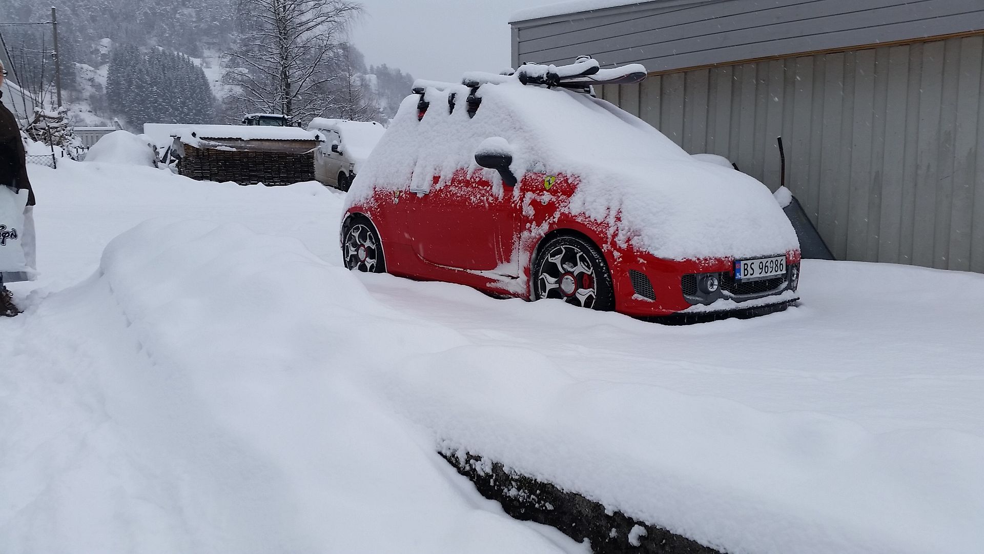

    Love the shots in the snow. We don't get anything like that here in the UK.

    Beautiful car and country. I especially like the snowy pics. I drove there once on a frozen lake, great fun!
    Great DIY work, too!
